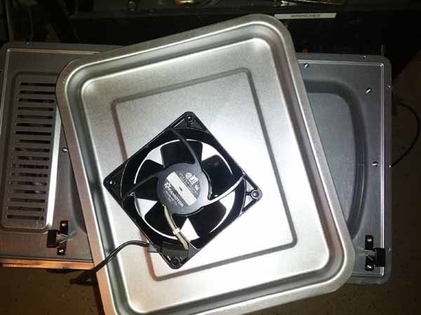

Now let me speak for a moment about cooling.  Most others on the web simply open their door during the cooldown phase.
A very few have added a cooling fan and some very strange contraptions to block open and close vents.  Here is my solution thus far:
The rear of the oven has a bulging metal piece as shown below:
I found that the roaster pan that comes with this oven fits this bulge perfectly and only needs to be trimmed at one end.
I have a nice Pabst metal blade fan that I will use for forced air cooling.
In the image below you can see where I have drilled air inlet ports in the rear panel, and air exit ports in the bottom of the unit.
Since hot air rises, these ports in the lower end of the oven do not "leak" heat from the oven.  They remain relatively passive until made active through forced fan air movement.
The next step is a trimming of the roaster pan to fit over the rear and direct the fan output through the new inlet ports.
"CAUTION" "sharp edges" "there will be blood"
Once trimmed and the fan is mounted, I simply routed the power cord of the (115V) fan back into the controls section.
In this image below, you can see how the addition of a solid aluminum front panel allowed a solid mounting of the controller, the switch, and the solid state relay.
All wiring is complete and the unit is ready to close up for initial testing.
